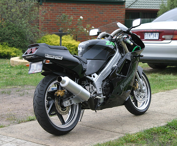

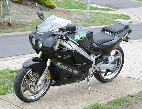

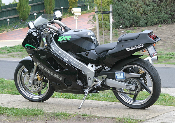

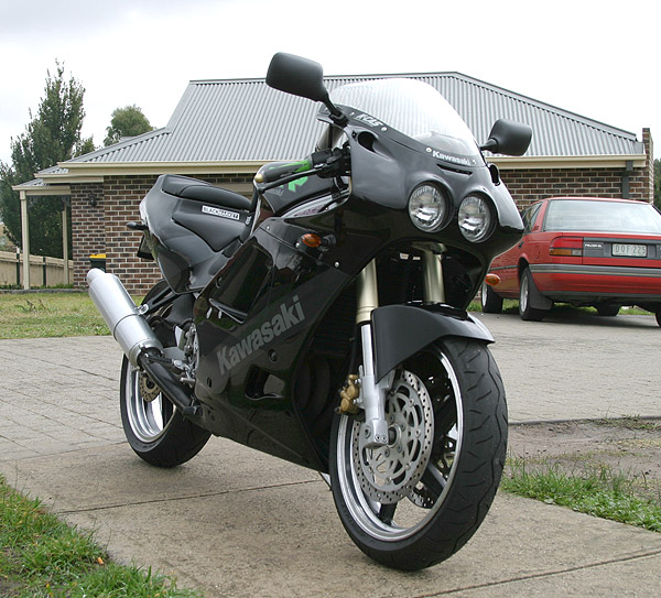

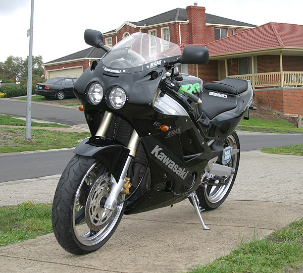

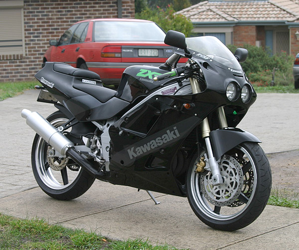

Stripped the outer edges of my wheels and polished them up this weekend.
Thought it might be the perfect opportunity to take a few piccies as well.

Thanks for the kind words, makes all the cleaning seem a lot less painful..
The rims are almost mirror polished. But they still have marks on them from the old paint, so its gonna take some more work to get them perfect.
