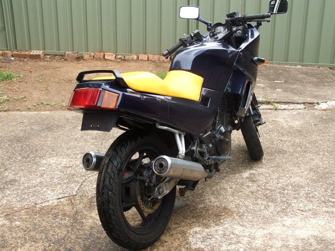

Hey guys, sorry to bring this thread up from the dead.
My GPX is jap spec (well its ass is, it only has 1 front disc).
I ready you guys sayin that its not roadworthy, to have the indicators alongside the brake lamp. But from Federal Register of Legislative Instruments F2005L04012
Australian Design Rule 19/02 Installation of Lighting and Light Signalling Devices on
L-Group Vehicles
Appendix A – UNECE R53
17
According to my mate, the indicators are 182mm appart and meet the initial criteria.
Thanks heaps
Ben

- The current rear end
- gpx 3.jpg (116 KiB) Viewed 5509 times
