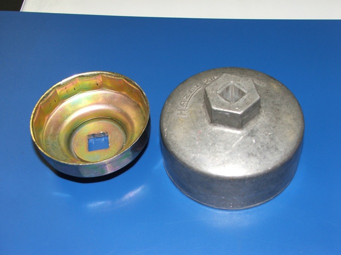

Yep use these all the time & have a few sizes in the tool box :shock:
filter tool.JPG (70.5 KiB) Viewed 3596 times

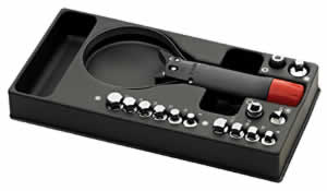

bought 1 from super cheap for $10 or $12 i think
is same principal as the one below turn the end to tighten strap
didnt come with sockets for sump plug

robracer wrote:Yep use these all the time & have a few sizes in the tool box :shock:
The one on the left is the one I have hanging on my toolrack, the one of the right looks pretty heavy duty :shock:.
