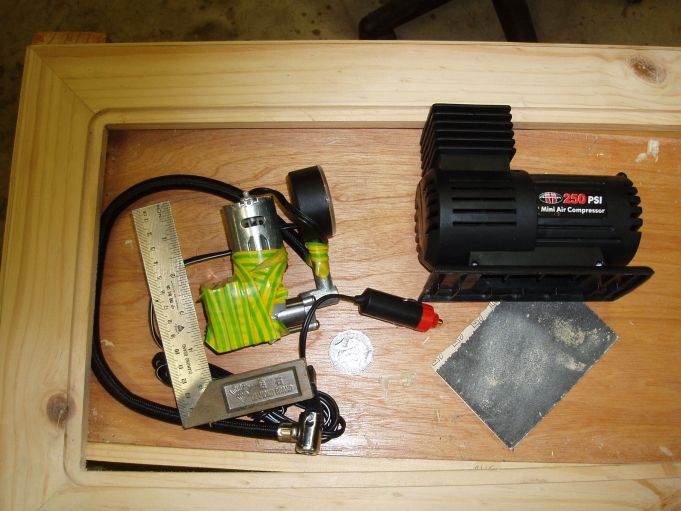

aubeasty wrote: 3) I have seen someone strip down an air compressor to it's basic essentials and he has it under the seat for such emergencies (yes, powered off the 12V cig lighter socket he has installed)
That would be me :D
Heres my rant :lol: It works, and lets you adjust pressures if you feel the need (eg when touring drop for twisties and go back up for freeway if you want to save tyre wear)
Saw a little 12v air pump at BigW for $10.90 so I grabbed it because my foot pump got crushed, by my foot
Got it home and straight away pulled it out of its case (which is shaped to look like a fancy air compressor with cooling fins and stuff) because I knew it would be 50% air inside.
So the actual compressor is 1/3rd the size of the case thumbs up
Made a little metal bracket to protect the exposed mecahnisims and it fits easy into a corner of the tail
It works fine, gets hot and is noisy (like as noisy as the ZZR Shocked ) Gave it a grease up, because it had none and straight away it ran about twice as fast and half as loud (what do you expect for $10, with the price of oil these days grease must be too expensive).
So for the space it takes up (not much more than the canisters for the puncture repair kit) I think its a good deal.
Takes a while to pump up but good enough.
Can drop tyre pressures for twisties then go to 40+ psi for a long highway stretch when touring.
Much cheaper than those stupid repair kits, which I have decided are sh*t after trying to use the thing in my garage when I had a flat in the morning.
I think the $5 repair kit that was next to the pump would be better, though a little bulkier because its tools have proper handles you can get some leverage with (which you need to pust the stupid plugs in).
So if your thinking of a repair kit I sugest BigW pump and kit combo for $16 (+30 min repackaging, and a lighter socket makes life easier then taking the seat off to access the battey) rather than a stuipid $40 single use motorbike kit.
Pump also lets you get home on a slow leak with multiple refills, where canisters will get you single use only.

jmuzz, I'm both sad & happy at the same time - as it's NOT you that I knew who did this (the sad bit), but the Happy bit is that you've provided the instructions on how to do it!!! The only diff is that this other setup didn't have the dial on it anymore, as the dude used his own separate pressure checker....
But hey, you've posted it for the world to see so maybe a few will try it out (me included) :)

aubeasty wrote:The only diff is that this other setup didn't have the dial on it anymore, as the dude used his own separate pressure checker....
I was going to remove the dial because it drops 1/3rd off the size. But it fit anyway so Ive just left it. Easier to know when its done anyway (the dial reads about 4psi higher then my digital gauge too, though it does loose a little pressure when disconnecting)
