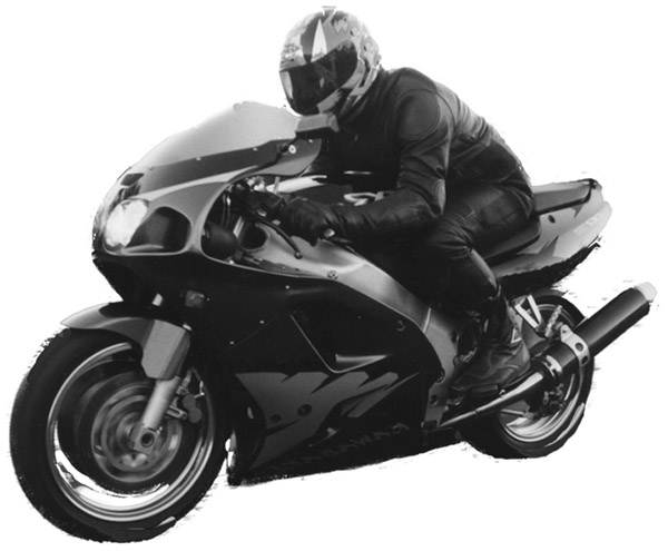

This was one of the first mods I did to my ZXR about 8 years ago. It wasn't to hard as it's mostly cutting away from the front fairing to get the two to match up. From memory the scalop at the top where the two meet required a bit of a tweek to get them to line up perfectly.Specifically the top/bikini to side/lower fairing junction
- Side BW.jpg (64.34 KiB) Viewed 3075 times
