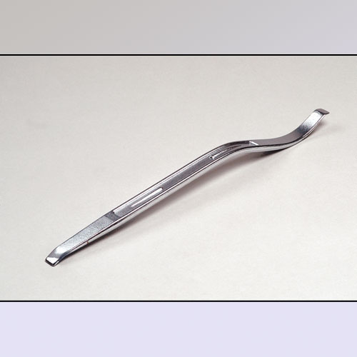

If you are going to get a set of levers get the ones pictured below.
I used to chage the rear tyre on the Blade about every week, sometimes two or three times so i ended up getting the hang of it.
I tries a couple different styles of levers but these were by far the easiest to use and the most gentle on the wheels.
Even with good levers like these be prepared to scratch some paint off and maybe nick the metal when learning.
Best to get someone you knows how to do it to show you.
As for breaking the bead i have used a variety of way from G-clamps to car jacks. to using wood and levering off the chasis rail of my 4WD.
If you are going to do it all the time get a bead breaker. I have a heap of pics of one you can make easy as if you are handy with a welder.
- michelin-tyre-lever.jpg (18.16 KiB) Viewed 2183 times
