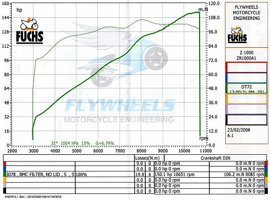

04 Z1000 full akro exhaust, pcIII with custom map, bmc air filter with air box lid removed yada yada
- a015.3.JPG (51.08 KiB) Viewed 3132 times

when i had the Z maped at doin bikes several years ago it made 128.6 hp and 93.5 nm at the wheel. on this dyno the figures were 150.1hp and 106.2 nm at the crank. given losses of 10 to 15% from crank to wheel the figures compare well. also both dynos show peak turque and power at the same point and the shape of the curves are the same. based on all this i think the results are about right.

I'm not questioning your figures Its the comparative figures to the 9's that looked odd..kawaden wrote:when i had the Z maped at doin bikes several years ago it made 128.6 hp and 93.5 nm at the wheel. on this dyno the figures were 150.1hp and 106.2 nm at the crank. given losses of 10 to 15% from crank to wheel the figures compare well. also both dynos show peak turque and power at the same point and the shape of the curves are the same. based on all this i think the results are about right.
If 150hp = 128 at the rear wheel (which sounds about right).
that would mean the zx9rs would then be 148 hp = 126 rwhp.. Which is a bit low for 02 / 03's with slip ons.. not a huge amount though.
Using the same conversion, Watties zx10r would be putting out 142 rwhp and Gixxerdaves K6 with full system and PC3 would be about 144hp. Glens zx10 (the same as Watties) 149 hp.. all a bit low to any other RWHP dyno.
The last dyno Day Watties had more HP than Glens, now Glens has 7 more (same models same mods), the 06/07 also had 5 to 6 more than the 04/05, this one had em the same as Glens 04/05..
The 12's should be about the same as the 10's but were much higher..
It looked like the bikes on early read higher than the ones on later..
BTW, my 98 zx9r put out about 142 on the doin bikes dyno.. and it was running crap...

i see what you mean, maybe the opperator was having an off day.
