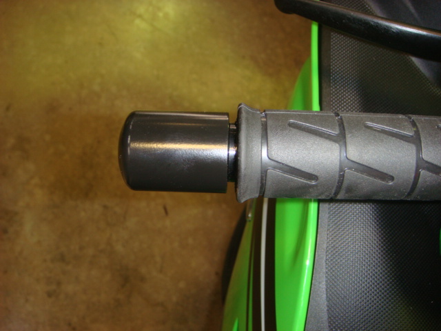

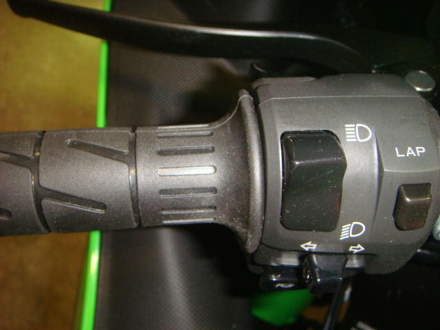

Re: Handle Bar question
Post by Flywheels MC »
Here are a couple of photos from a brand new 2008 ZX6R. The gap looks the same as yours so I wouldn't be overly concerned about it. Try stretching the grip towards the end or just colour that gold bit black so it's not so obvious

hidepenny
Posts: 970
Location: Melbourne - Eastern
Post by hidepenny »
thx much for the effort and explaination....i had to pull and twist it really hard to move it down.....now there's a gap between the grip and where the light button part is......so it looks like the right hand side.....
