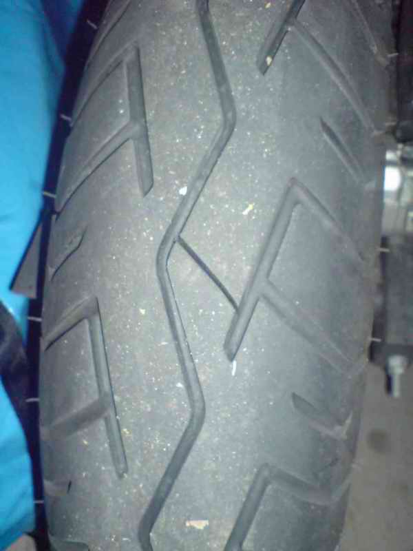

Went with the crew up for the Putty run today and at halfway saw this cut in the tyre. Goes all the way down to the inner lining... Dealer says its a long shot for Kawa to replace the tyre. Didnt hit anything that I know of other than crossing a few bridges and railway lines along the run.
Bike is less than a month old (Ninja 250) and just clicked over 1650 kays
Just wanted to ask everyone. I know Hoffy's response is that i should approach Bridgestone Aus... Its a new tyre for the new bike so Bridgestone probs havent seen one yet!
What do you all reckon?

- 1650 kays old...
- stuffed tyre 1.jpg (28.98 KiB) Viewed 2909 times

I've heard of a few Bridgestones losing big chunks out of the tread recently - delaminating up to a third of the tyre in some cases, apparently.
Haven't seen one, but the rumour alone was enough to put me off buying another 014, even allowing for the usual 80% bullshit factor.
Anyway, this might be something similar. If it's a 'known' issue, Bridgestone might be open to replacing it, but I wouldn't count on it. To do that, they have to first admit there's a problem.

that is NOT a cut..thats a tyre block splitting and de-laminating off the tyre cordrob412y wrote:Went with the crew up for the Putty run today and at halfway saw this cut in the tyre. Goes all the way down to the inner lining
simply... a new tyre is rooted
and in proof ...why is there NO cut either side of the tread groove??
If it was a cut from glass or whatever...why didn't it cut the tyre past the tread groove?
imo...that is a manufacturing fault by Bridgestone ( and I say that having worked for Dunlop)
and as its fitted to a brand new bike..Kawasaki have to get involved , at least initially
even if they then pass it off to Bridgestone
go the dealer first and if he tries the handball...tell him you are off to Consumer Affairs
and the ACCC...Product Safety Policy Section of the ACCC handles consumer complaints
about unsafe products.....and that tyre is about unsafe as you can get!
hth
