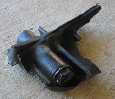

I had no warning. Mine just went "clatter, clatter, CLATTER, CLATTER, BANG!!!" on the way to work one morning. The only up-side was that the back tyre didn't lock up. At the 100km/h I was doing, it could've been messy! :shock:
I didn't realise exactly what I'd done until I pulled the fairings off and found this nestled amongst the header pipes...
