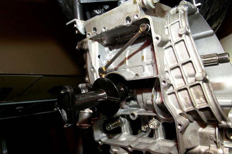

Re: ZX7R - Oil Filter???
I just took mine off and it appears completely stock...although not an original Kawasaki item. There are a number of extra oil lines that have been added to the Superbike engine, especially lines that pump oil up under the piston. I am not sure wether this system is total loss or not but I would not think all the oil goes through your filter to get to the top of your engine. I have not had a look at my road engine yet to compare the differances but from memory they appear different. I am not sure as to what percentage of oil gets filtered during a specific period but a total loss system would need a large filter with a high flow rate and the last thing you want is to have your filter stuff up and stop all oil flow.......please don't quote me though as I have not seen a pic of the oil lines.
Just to get you thinking.
