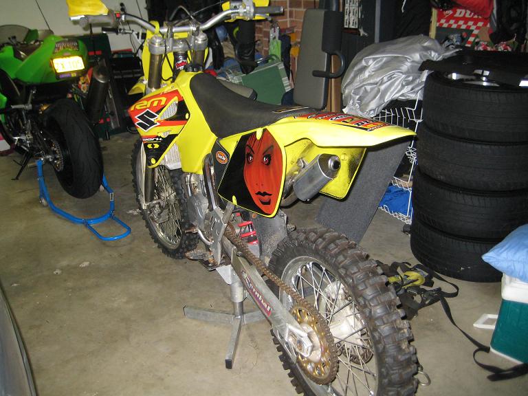

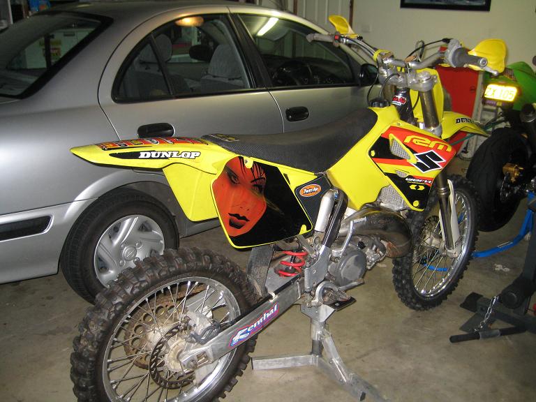

Here's the new beast. Wanky graphics but they'll go pretty quickly
- rm125 1.JPG (91.95 KiB) Viewed 1892 times
- rm125 2.JPG (89.43 KiB) Viewed 1894 times
