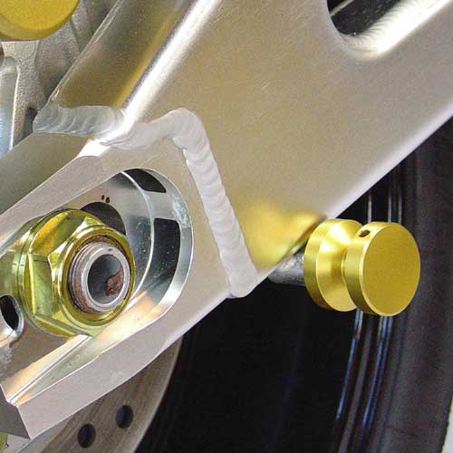

They go here:
- swingarm_spools_03.jpg (27.38 KiB) Viewed 2825 times
