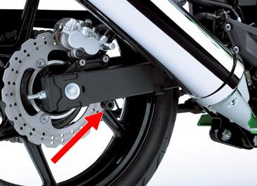

250 ninja swingarm.jpg (21.51 KiB) Viewed 2529 times

Can't get much clearer than that thanks to Spex :kuda:
(use imagination re RED arrow on your bike (arrow not included on 250 ninja's :lol: :lol: ))

I'm not totally stupid just had no idea what a spool was ahaha :P But thanks Spex, definitely the best way to explain it.
