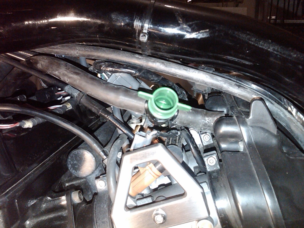

I spent a couple of weekends here and there stripping it down and cleaning it up, front and rear wheels off, cleaned, bearings greased, pads checked, calipers cleaned etc etc. All the plastic and tank off, while it's been off I did the 'Wattie Kleen Air ON/OFF Modification', cheers buddy Bunnings was the place and $3 total outlay :kuda:
On Off How easy could it be

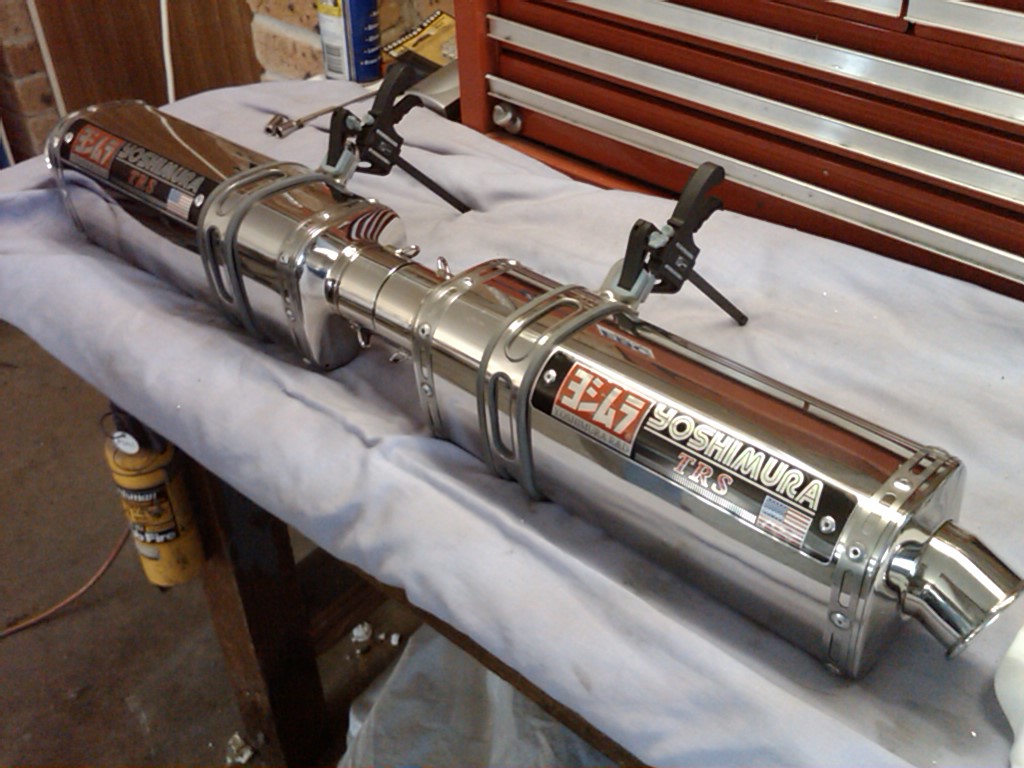

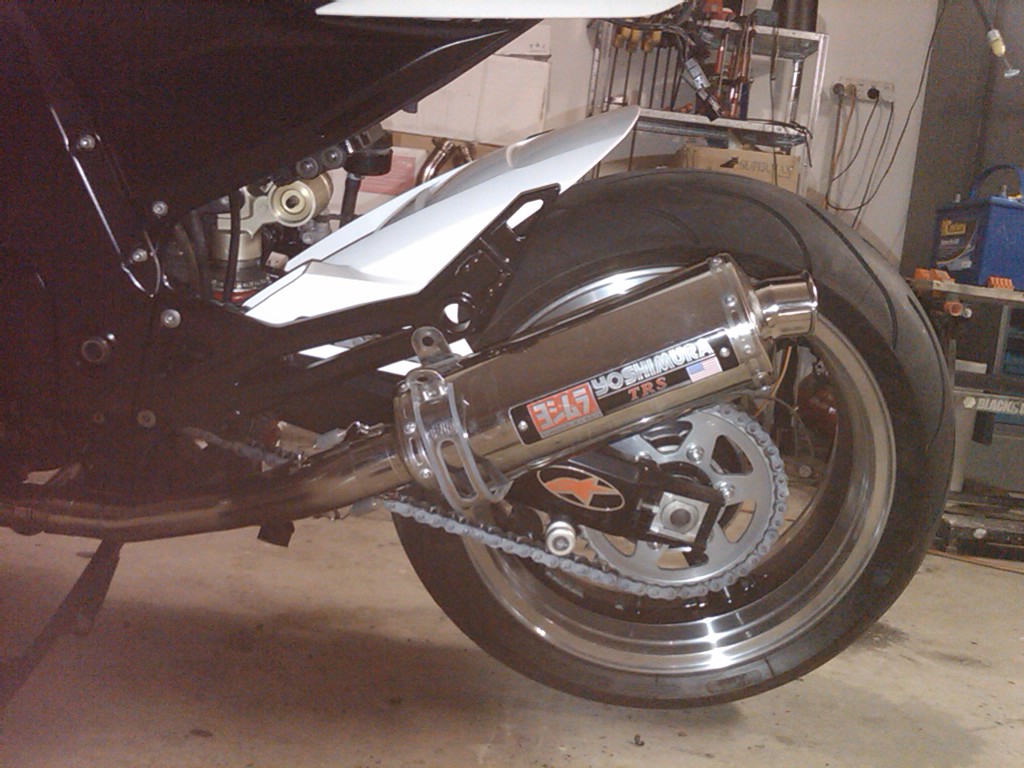

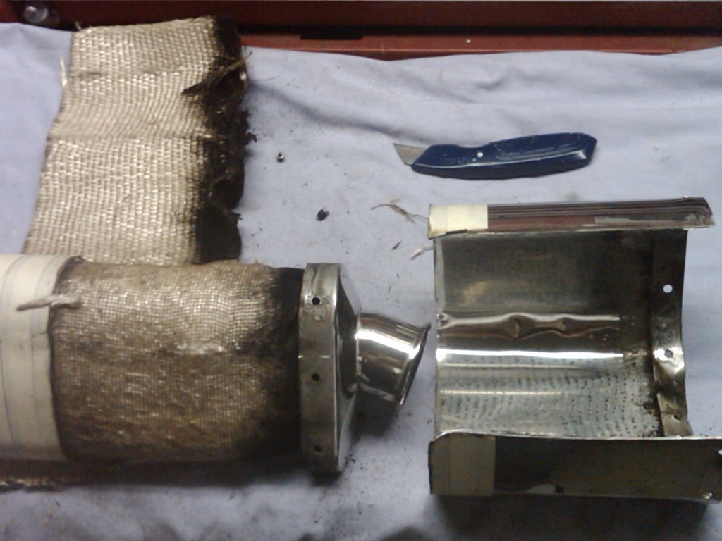

The Yoshi's got some extra special treatment, chopped about 175mm off both the damaged can and the good one, thanks to the fellas down at Mat Mladin for sorting me out with an old Yoshi skin with a spare old school badge on and a new locking band, FOC :shock: Cheers guys.
Wire wheeled, sanded and polished the headers (that horrible dodgy gold with the corrosion and crap all over them) system now looks like a complete stainless, well happy.
Ahhh cutting wheel
Ahhh cutting wheel

Loosly in place. Happy Jan!

Thats not the KLEEN mod.. Thats some stupid idea wattie had to put a tap on it in case it didn't work... It always works but he was young and dumb at the time he did his z... You don't need a tap, you'll never turn it on.!!
Just route the 2 reed block ends into each other with one small bit of hose, piss all that other hose and tap off and block the hole in the airbox, a rubber chair end cap fits perfect or just use duct tap and zip tie...
Thats what Wattie has on his 10 now he's a little wiser...
Nice chop on the pipes though...

go the tap option, in case you become a tree hugging greeny in the fore-seeable future. :lol: :kuda:

Davo, I guessed that when I started poking around, the cross pipe at the front of the motor and all the valve inlets could be blocked off. It is messy under there with all that farkin rubber, I may rip it all out. For now on off is good, even if it will never be on. As Hoffy said I may become a tree huggin ferry drivin pot smokin hippy and turn it back on :D
