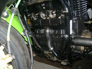

My 2002 Rex is one that has to have the header pipes removed to change the oil filter, this means taking the radiator off to get to the pipes. Alot of work for services. I've bought a Murph's spin-on oil filter adapter and have decided to fit it myself,
for me this is abit of a project.
So far the seat,the tank, and the radiator are off, tomorrow the headers come off and then into the filter housing. Any tips apprieciated.
The attachment DSCF2125.JPG is no longer available
This is the Kit.

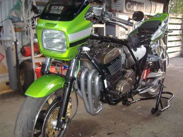

The bike so far
The bike so far

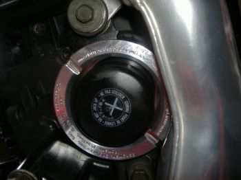

Getting the Rex up off the ground makes the whole job easier
The attachment DSCF2126.JPG is no longer available

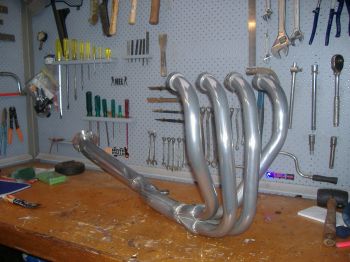

And yes Phil this is a good opportunity to give those hard to reach places a polish
Also the pipes

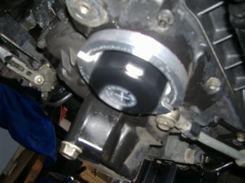

This is the adapter when fitted
Filter changes will now be a breeze.

Hey Ezza, where did you get that motorcycle jack from and how much are they?...I've been looking for something like that but had no luck.. :kuda:
ezzazrx
Posts: 97
Joined: Mon Jan 26, 2009 3:51 pm
Location: victoria
Re: ZRX Oil filter
Post by ezzazrx »
J-Rex I got it from a company called Radum pty ltd in Tullamarine---$100 plus post---came through the mail-cheap.
