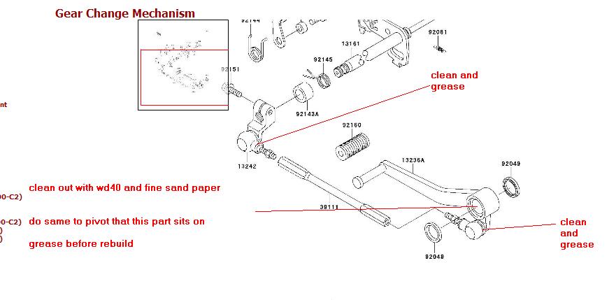

Hey guys, i went for a ride yesterday on my zx9, first time in a while, im in melbourne, i went up around cardinia reservoir to emerald, then down to beaconsfield and back into the city, it took about 3 hours (including lunch) and i was taking it pretty easy, sitting in between 80 and 100 for most of it... NEhu! on the way back, i was sitting at about 70 and the revs were at about 3 1/2 grand and i tried to put it up into 5th... i was feeling lazy =P i kicked it up but nothing happened. the gears didnt grab so i knocked it back down and there was a big clunk, then everything was fine again... was this entirely user error? it was a pretty hot day aswell, probably close to 40 with heat off the road, i dont know if that could be a contributing factor. Anyway, any thoughts would be helpful, cheers guys!

IF you didn't kick it up far enough....... operator error
, knocking it back down without the clutch will cause a clunk too
However, the 9's do love a little care and attention to the pivot points on the gear lever - if you haven't done it yet, then it's worth stripping the linkage, cleaning and greasing the pivot points
- gear linkage.jpg (41.63 KiB) Viewed 2175 times

yeah, i may have not put enough effort into the gear change...
ah well, live and learn.
As far as giving the lever a clean, should i pull it all apart, or can i get away with just removing the lever and a few bolts... im a hands on guy but i havent done it before and im pretty paranoid about putting everything back together the right way... the less i take off the less there is for me to scew up! =P
(thanks for the diagram too! handy)

those ball joint type things with the clean and grease red lines. Also check that where the are fitted to the levers that they are not loose, just had my six apart and they had worked loose so just peened the rivits over and it shifts better now, a lot less sloppy.

I'd love to take the credit for it, but I got it from somewhere else (buggered if I can remember though) & knew it would come in handy to explain to someone elsecraig wrote:Rossi you should publish a revised manual ........."for mechanically void riders" that denoted graphic is what most need to try minor tasks if not sure of their ability![]()
