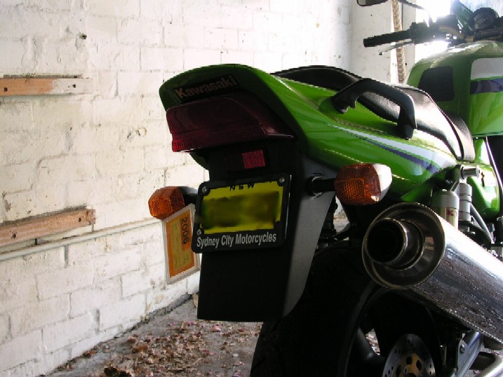

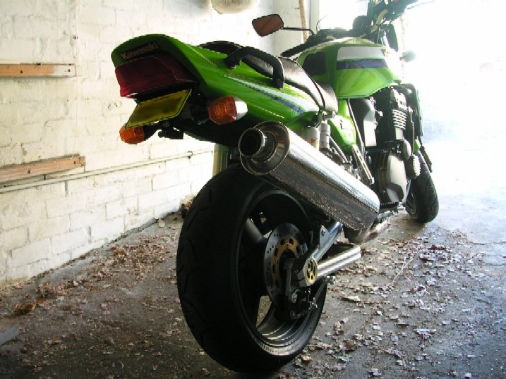

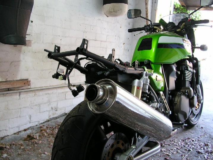

I can show you a before and after for the rex but i didn't take any of the process but I don't have any at all of the 97 zx6.
On the rex I actually removed the whole guard assembly which was a reasonably time consuming job, then cut the entire mudguard bit off. I got a number plate holder to attach to the bottom of the guard to hold the plate and indicators.
On the 6 I just marked it with a paint pen and cut it off using a hack saw blade then tidied it up with a file.
If I were you I would just cut it just beneath the numberplate bracket.
Matt
Matt
- original
- rex_originalguard.jpg (98.92 KiB) Viewed 4113 times
- undressed
- rex_undressed.jpg (116.75 KiB) Viewed 4113 times
- new
- rex_newtail.jpg (117.42 KiB) Viewed 4113 times
