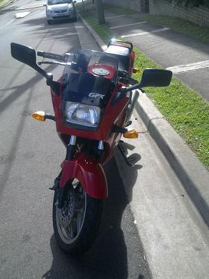

This is what the front looks like if this helps (awhh my old bike i miss it so much)
bike 9.JPG (23.94 KiB) Viewed 8012 times

Re: Changing the front light bulb on 06 GPX250
There's a thingy at the back of the light globe you turn counterclockwise to get the thingy out. Then that thingy has the globe attached... Remove globe, buy replacement (same type) and without touching the glass surface replace into the thingy and reverse process to reattach the thingy 8) Does that help? :lol:

Just remember the guy on the youtube video only took the front fairings/headlamp off to give you a better view. It might take a bit of feeling around but it should be able to be done without removing them.......right???
Net in my experience. I have big man hands, and didnt stand a chance at getting them in there on my gpx. the fairings are deceptively easy to remove and replace, the entire front section comes off with 6(i think) screws, and you have to reach in and disconnect the indicators then carefully remove the fairing. once its off, you can easily get at the back of the headlight.
Its useful to know how to remove the fairings, because if you get stuck in the middle of nowhere and need to get at the engine then its good to have done it once before.
Your under seat toolkit should have all the bits you need to do it.
oh, and dont drop the fairing when its off, it does alot more damage than you'd think
you may be able to reach up and under to do it. There is a rubber boot around the back of the headlight to keep water out, also the connector inside should just be a spring that goes across the globe and locks at the back of the headlight. You may find that from underneath isn't practical, though in the above video you can see how it looks at about 1 minute into the video.
