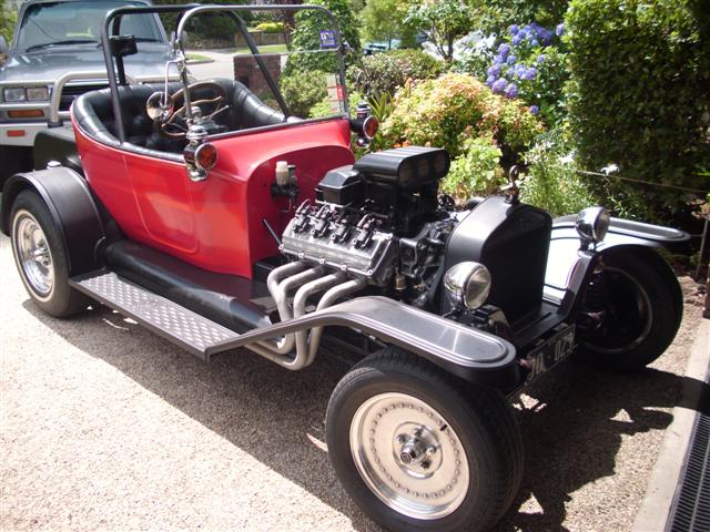

But as I've learnt from the family, you can fit anything into anything if you try harder enough or for long enough. Our last project below is a case in point.
Keep the chat coming guys. Very appreciated.
Hot Rod (Small).JPG (82.21 KiB) Viewed 4293 times
