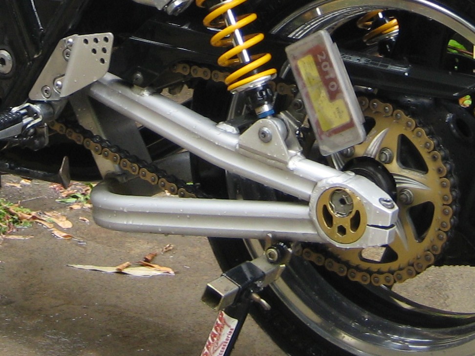

Re: Chain and Sprockets for the ZRX
JetPilot wrote:I use either a DID or EK chain.
I always use RK X-Ring chains, 530 on the Rex and 520 on the Zed. I also use std gearing and have trouble keeping the front down with 120 rwhp. Rod has lots more (trouble - that is)- I can vouch for it ;)
Site sponsor Superbike Supply has a deal you can get RK chain and Vortex sprockets for a good price, I also have vortex sprockets on both bikes.

Yep, thats it. As I said I have a 520 on the Zed, but 530 all the way with nthe ZRX. Although, quality of chains these days is better than it was say 15 yeras ago, a 520 may be OK depending on how hard you ride it and if you make it wheelie lots........
I am pretty sure you can order other sizes, I did ( i got 2 x fronts, 1 x stock and 1 x -1.
