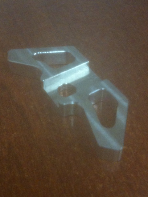

Heres what the an after market servo bar looks like, it basically stops the servo at the right spot.
Excuse the pic but my I phone got a bit wet yesterday & the lens has condensation on it
