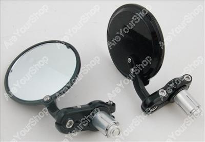

These came in the mail today...
$24 on ebay, free postage from 'begoniasale' (HongKong)

Then the mirrors...
Dunno if it's the norm for bar-ends but they were a bit of a bitch to get tight in the bar AND in the right position - but I got there. Was a little complicated by the fact that the left bar was a bit squished - it had obviously had a little drop (before I got it) - so I had to spend a bit of time making it round again so the bar-end would go in.
I haven't ridden with them yet - will see how they go tomorrow ;)

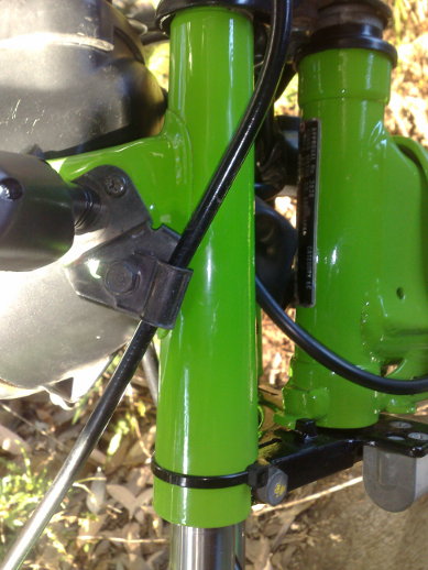

I've had to do a minor dodgy repair today :(
Nothing really serious, but looks like the left headlight bracket weakened and broke where it attaches to the top of the fork - sometime during the week.
I noticed a rattle over bumps early in the week, and later in the week noticed the left headlight bracket was the culprit.
Thinking I'd just have to tighten up some bolts I got some time to have a look today and found it's actually broken :(
I haven't pulled it all apart so can't get a good pic of the break, but you might be able to work it out from my description and the above pic.
The brackets are basically just a cylinder with a bent-over/narrowed end at the top that sits on top of the fork and is tightened in between the top of the fork and the top triple-clamp.
The metal has broken all the way around at the top, leaving the cylinder to rattle up and down.
My bodgy repair is the cable-tie you can see around the bottom - the gap between the bracket and the bottom triple clamp was just about the same size as the width of the cable-tie, so it's a 'perfect' fit, holds the bracket up, and has stopped it rattling (for now).
Not sure what caused it - perhaps repeat removal of the headlight (eg for the indicators) without loosening the fork bolts stressed/weakened the bend (so maybe the other side's ready to go too :( )
Not happy. Gonna keep an eye on it to see if the bodge holds well enough, or if I'm going to have to source a new bracket
