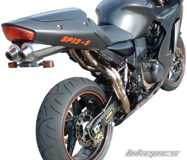

Re: ZX12R High up exhaust?
You mean like this one?
- ZX12R High Pipe.jpg (52.96 KiB) Viewed 4265 times
that look hot for a barge
Looks like it can be done. Do you know the brand of exhausts? Has the rear been jacked up a bit?
I'll continue sifting through the search results. Unless you have a link?
Thanks guys,
Found the owner of the pic and have sent him an email. Anyone seen any other high up set ups? This will keep my customer happy for a little while!
each to their own, but as a ZX12R owner, I think those under-seat pipes look shithouse on the Barge.
Have a look at the footpeg. Then imagine riding that bike, with your toes on the pegs. You would burn right through the inside/rear of your right boot, or ride with your right foot poking out at 45deg from the peg !! Totally impractical. Apart from that, you would lose all the storage area under the seat, and from the looks of those tail-pipes, the ECU would also need to be relocated.......
They just look.......wrong - on that bike.
+ 1Gosling1 wrote:each to their own, but as a ZX12R owner, I think those under-seat pipes look shithouse on the Barge.
+2 underseat pipes look shit on the 12.
