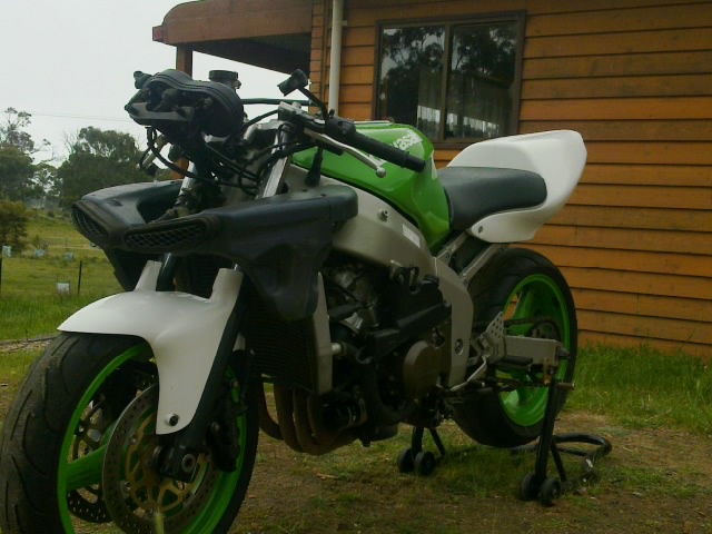

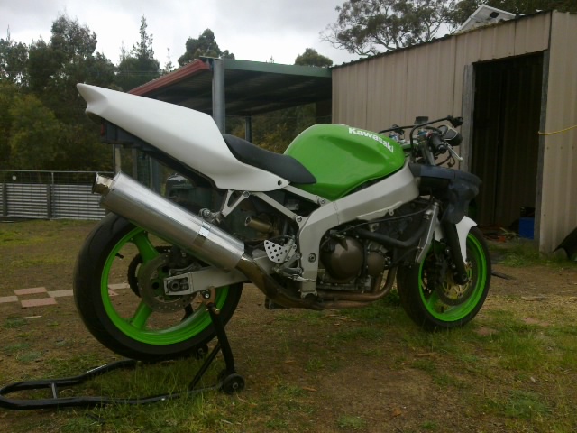

Re: Drilling through fibreglass
So far, so good......
- 23102010116.jpg (128.28 KiB) Viewed 847 times
- 23102010117.jpg (115.97 KiB) Viewed 847 times

Looks Great!

One thing I did come across, how do you secure the seat on given access was via the pillion seat....robracer wrote:Looks Great!
With the tail piece in place, you can't get to the bolt to hold the bracket on. Fibreglass doesn't flex quite as well as the plastic so it miakes life very difficult to get to the bolt...at the moment, the seat is just sitting there.
Even when I unscrew the tail piece and with the seat in place, it's still very difficult to get to.....

What a few people in the past have done was to cut out a small section of the tail right behind the seat, Directly over the bolt, so you can easily access it.

My 9 had a hole in the seat that you could poke a screwdriver in to lock the seat down.
