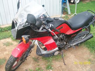

If the header pipes are still the 'turbo' headers, then they will all meet up right in front of the cylinder block.....has someone made some type of collector-box and a 4-1 system from this point ??? It would run pretty weird with an exhaust like this, as the header length for a non-turbo bike needs to be way longer than the turbo headers......can you post up a pic ?
Yes they are turbo headers they have made it so a straight bit of bike bolts to where the turbo bolts on to then it goes down to a y intersection so bike has a twin system with newish but genuine pipes and as for photos i spent near on 7hrs trying to upload on wknd but havent given up just got to work out how to down size my photos.

Re: WANTED GPZ Turbo and Accesories
with your photos - just right-click on the photo, select 'edit', then in Paint, select 'Image' , then 'stretch/skew' - then change the small box from '100%' to '50%' for each of the 2 boxes which are showing. This will shrink your photo by 1/2. You can adjust the stretch/skew setting anywhere you like, but for big pictures, you may have to shrink down to as little as 30% of the original picture. Save this picture, upload it to your Photobucket album, and just link the image from PB back here. Its dead easy......
Sounds like whoever had the bike before you, has done a fairly dodgy job on the exhaust. With such a short length between the exhaust ports and the collector box, the bike will have a pretty strange power-curve .....

finaly
finaly

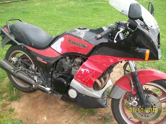

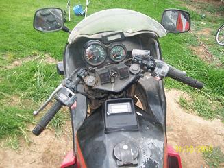

Well thanks Goslin for your advice with photos and here she is ,a bit gruby but with new paint she "ll be halfway there.I will send more photos later.cheers
