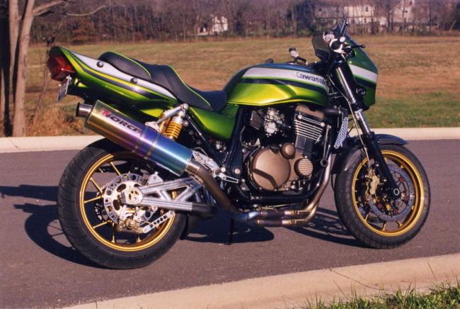

Came across this photo of smoenoes bike (from zrxoa), with a TiForce. :supz:
Schastleevo's bike from zrxoa. Sexy or what!!??

No quality issues as far as I am aware with the TiForce. Greedy has one on his Rex and it looks great, quality is right up there with the Akra / Arata IMHO.
I would get a TiForce over a Yoshi anyday (except in the rainbow colour :vom:) - the way you feel about Kerker's, I fell about Yoshi's :lol:

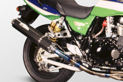

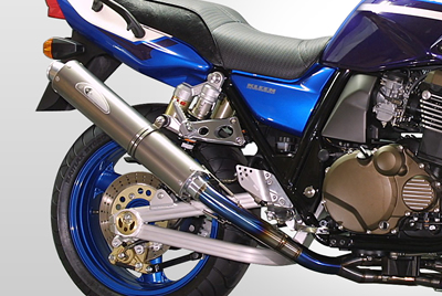

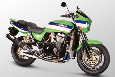

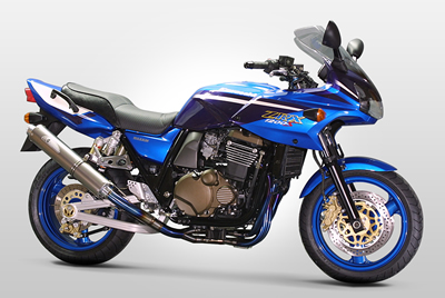

What about this. Anyone heard of a Japanese company called K Factory? They do titanium systems and aparantly have a very good reputation over there in Japan.

When you place your order you can opt for 'blued' headers & mid section. If you like, they also have another process that gives a golden hue. (all hand bent ect). With the can, you have the options of 'blued' titanium or carbon or straight titanium. Also, you can choose the size of the can.

Yep, I've got K-Factory saved to my bookmarks :lol: , there stuff is pretty trick. I have a K-Factory fork brace and carbon fork protectors on my ZRX as well as a K-Factory rad guard.
Just beware when buying systems from Japan, make sure that they are not domestic (Japan) market compliant, otherwise they will be 92db and require gutting. Race systems do not have the same issue AFAIK.
And yes as far as pipes go, you do get what you pay for. In the quality stakes my Kerker is not in the same universe as the Arata on my Z, nor the Akra that was on my 9 - or on any of the ZRX's I've seen ;) .

I could go on with a lot of explanations for all this, but if you look at all the systems on the market, you will notice there a huge difference's in their configreation[spelling] so take note the TiForce system in the pic [to me] looks the best system ive seen so far for the ZRX.. IMO
