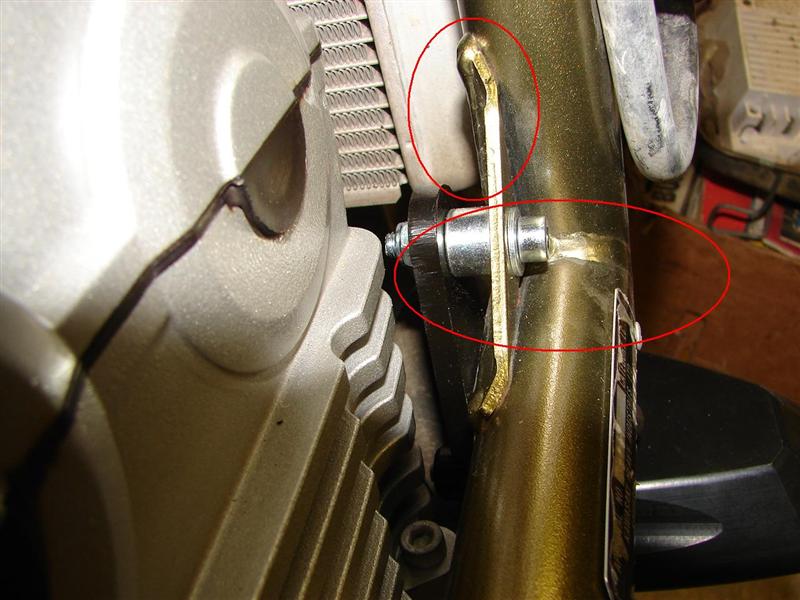

Some early models ( France & US ) experienced frame cracking in the areas in red in the attached pic. Not sure if it happened here,
but the vibration was enough to crack the metal bracket on the OEM crash knob brackets. ( Crash knobs & brackets shown are the 2nd gen. replacements ).
- DSC00739_1 (Medium).JPG (80.62 KiB) Viewed 1065 times

When I received the replacement OEM crash knobs, in the install notes it mentioned packing the free space between engine mount and crash knob mounting plate to eliminate any gap.
The gap on each side when I removed the 1st gen. knobs was 3-4 mm !
So .... maybe loosen off the engine to frame mounts one side at a time and pack the gap with suitable washers, so the frame is not pulled back to the mounting plate.
