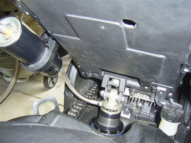

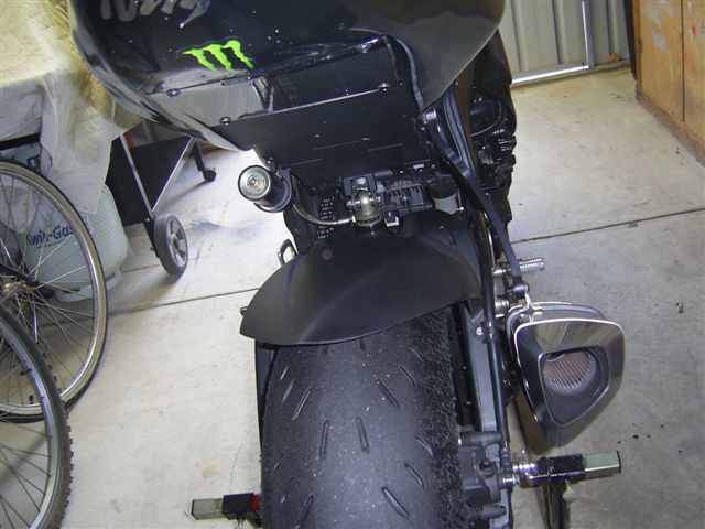

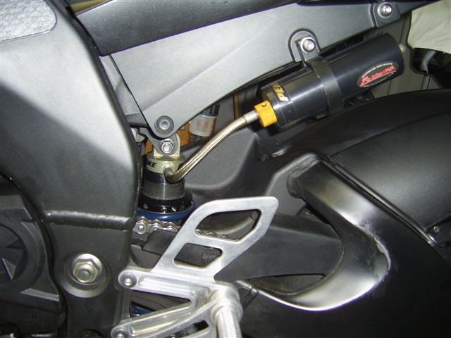

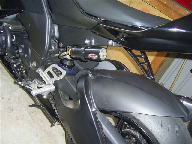

I have now replaced the stock rear shock with a Penske shock. Same spring weight (9.17) but with much more adjustment, ride height adjustable and better valving. I am sure that it has to be better than the stock one for sure. ..!! So it's been installed in the bike, ride height set as per standard, as I am used to that, and everything else set in the middle for a start. I cant wait to test it out on the 10th and 11th of Feb at the island. Just got to get the sag set first and I am off...
I have also done the new brake pads, got rid of the exhaust servo with a 'servo buddy' so now plenty of room for the power commander... and I am even thinking of getting rid of the air induction pump as well.. just to clean up that area.. I currently have a marble in the hose, but if I am not using any of this stuff it would work better if I got rid of it completely..
So the bike is looking and feeling really good so far.. next update will be onthe rear shock in a couple of weeks.. here are some pics of the install today... It fitted perfectly.. just had to make a few small adjustments to the reservoir holder, but apart from that it was a very easy install....
