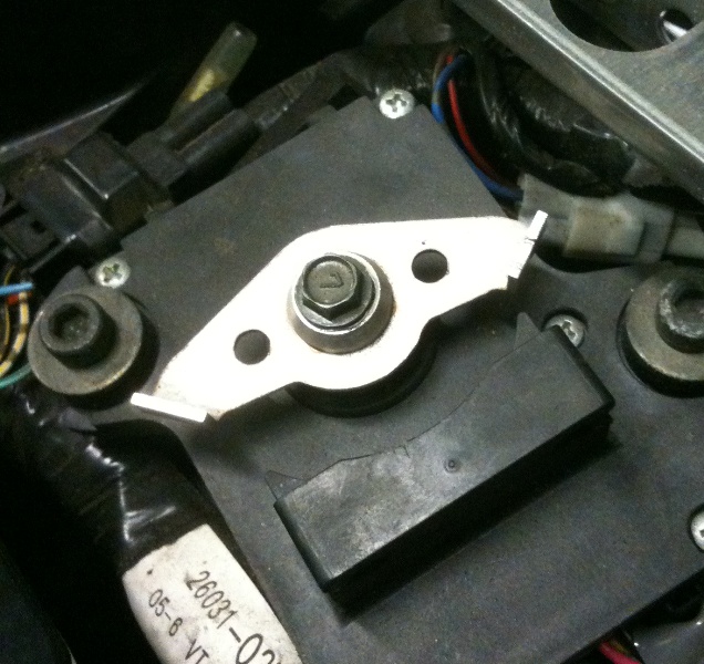

If the servo doesn't Reach a limit it can set a code off.
Robracer explained to me how to do it in Red Daves old 6. I put a flat length of alloy about 10cm long and put it onto the top of the servo, then when it spun it hit the subframe and stopped, then went back the other way till the other end hut the subframe and all was good.
Maybe rob can take a pic if he still has the same setup on his bike?

Yep just checked & my one is farked, not moving at all....... will have to get a servo buddy now
Here is the current set up:
- IMG_0684.jpg (154.36 KiB) Viewed 5988 times

oh, not the subframe, just the plastic block.
