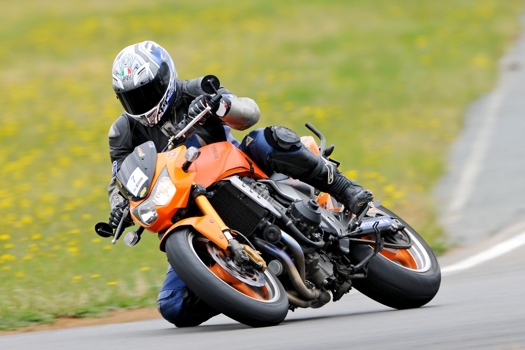

Re: Z1000 Fork Upgrade Complete
Went to a day at Wackyfield Park on Wednesday, made some further adjustment to the forks over the day.
I'm going to see how it goes on the road now, doubt I'd ever use the brakes on the road as hard as I was at the track - especially after doing a pillion lap with Mr Giles last Friday at Phillip Island..........I have obviously got ALOT to learn in regards to braking :shock: :shock:
BTW, big thanks to Keith Muir for the photo ;)
