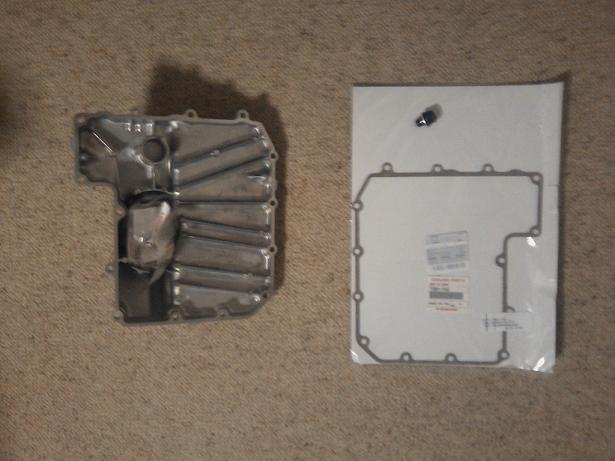

98ninja
Posts: 695
Location: Inverell
Re: Sump
Post by 98ninja »
BOOM!
take that murphy!

98ninja
Posts: 695
Location: Inverell
Re: Sump
Post by 98ninja »
Sooooooooo, before I bolt all of this on, should I clean the sump?
or will it be fine to bolt on and whatever maybe on the new sump can mix with the oil
99 zx9r - back
Re: Sump
I'd take it as an opportunity to give it a once-over scrub with degreaser, i mean seriously when is it going to be this easy again to clean it up?
holdontight
Posts: 110
Joined: Tue Nov 24, 2009 7:37 pm
Location: muswellbrook
Re: Sump
Post by holdontight »
Clean it first. It cant hurt can it.
