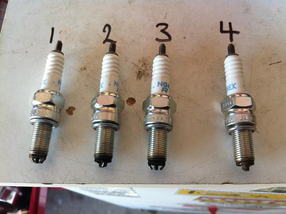

Take a photo of the plugs glen

Here you go Tim
These were the plugs when it played up last Saturday. You can see 2 and 3 are much sootier

Kinda what I said to Glen on the tellingbone. I reckon it's been jetted too rich and is wetting the plugs. But, what would I know.the kid wrote:Check the air gap on the ignition trigger and if its a twin trigger system system you may have a trigger issue for 2/3 .
Also if its overfueling in the center 2 cylinders , wetting a modern plug especially NGK's will kill em
From my man , Nobby @ Hyside Trading

Yep looks to be running richer On 2 n 3, if I remember correctly u said its more apparent when it's hot?
This is only how my brain works, but..... If it started ok after new plugs then played up a bit when warm, then was a bitch and didn't run on all 4 after the plugs have been heavily sooted.
Id be going for the Carby glen, if the original air filter don't change anything then I'd be looking at needles and jets. Also mixture screws
