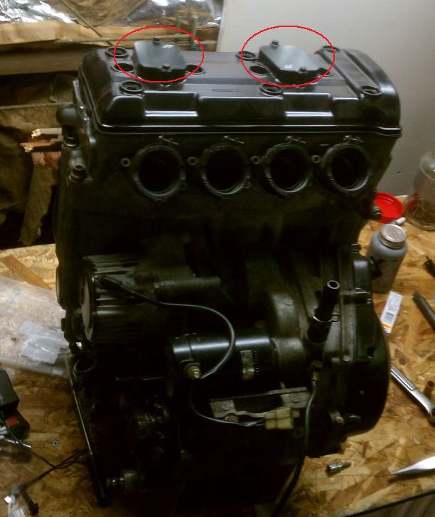

Hey all; needing some advice on what these things are and if they'd be recommended for my bike!
I'm currently rebuilding a '94 ZXR750 to use as a track bike and am wondering if I can do away with some of the air/vacuum lines under the air box and have noticed the parts in the title; "Smog" block plates by a company called Driven in the US which look like they block off the vents above the reeds valves from the cam cover and I'm wondering if I fit these will it have a negative effect on my bikes performance :? ?
I've attached a photo to show what I mean :)
ALso; do I need to connect the pipe off the top of the carbs to anything or can it simply be blocked :? ?
Thanks
Smog block plates.jpg (109.21 KiB) Viewed 1331 times

Block off plates are fine, they make so
Performance difference what so ever.
You need to be carefull with any if the vacuum hoses on carbs. Some are a necessity. The one coming from the smog
Plates can just be blocked off.

So I should be fine to remove the reed valve plates and connect the two hoses together?
Strong smell of petrol in those hoses after running the bike for a bit; is my cylinder head be leaking?
