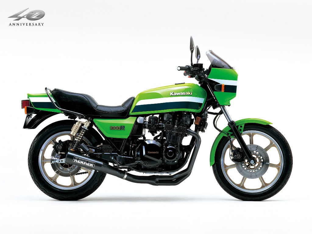

Seen the pics on the Kawasaki website celebrating 40 years of the Z? This one is my wallpaper on my PC

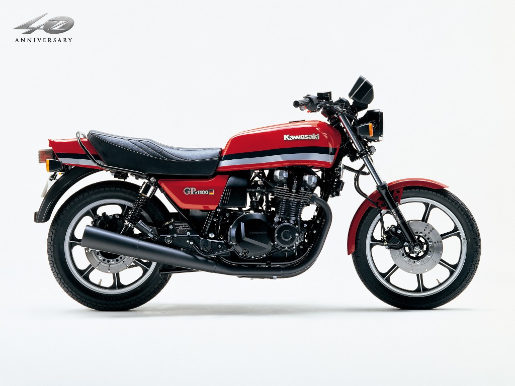

There is also this one, I'd prefer the one with the bikini fairing ;)

hmmm 1000R how tasty :kuda:
