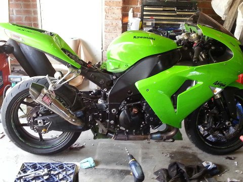

Re: single yoshi on a 07 zx10
this is aprox where i want it to be,im only realy changing it as i like the look of the single on the 2nd gen
Get a EKJ kit so you can tune it on the run & not have to worry about the cost of dyno time..
