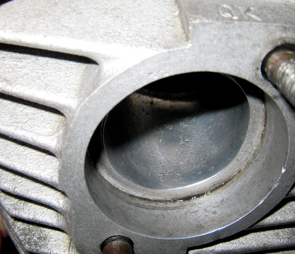

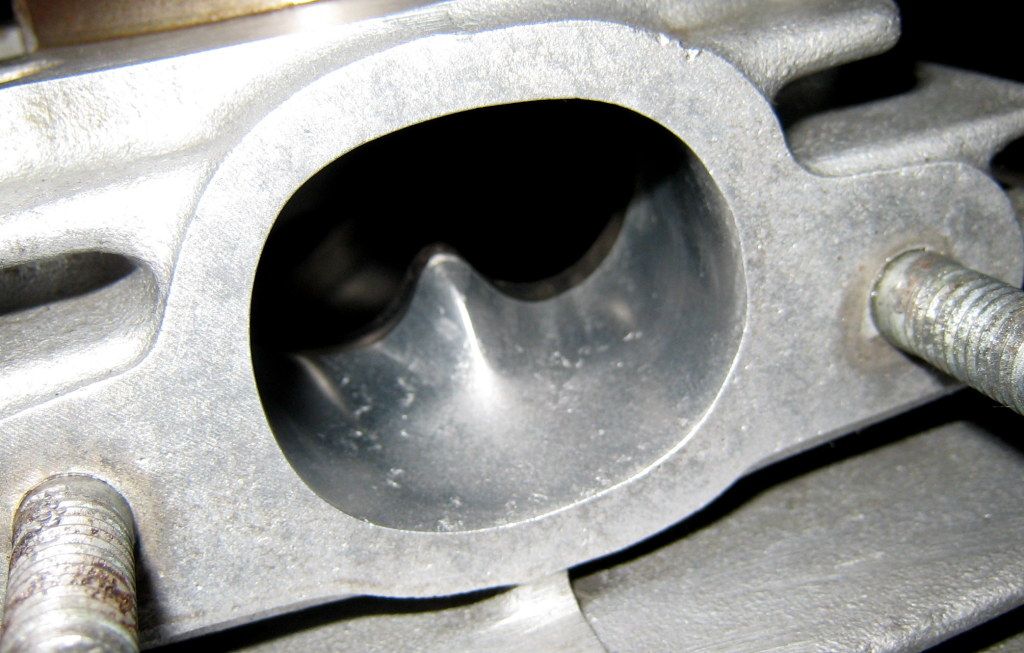

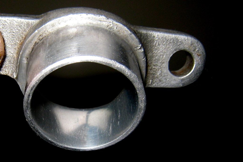

Here's a before and after shot of one of the carbs that was left to soak in white vinegar for about 3 hours then scrubbed using a toof brush.
The grime literally fell off.
Also I'm pretty sure?...that both the inlet and outlet ports have been ported and polished at some stage.
Although difficult to see in these pics...the ports are super shinny.

$1.10 for 2 litres at Aldi....ProblemChild wrote:amazing stuff that vinegar. lookin great.
I've been advised...
" It is better if you roughed up the intake and port with 150 grit and polished is for dry flow".
Any advise on this appreciated.

mate I would just leave those intakes as they are. Someone has definitely cleaned them up and matched the liner to the barrel at some point in the past - you would need to measure the port dimensions from the top of the barrel down to the top of the inlet ports (and the transfers and exhaust) to work out if any porting mods have been done though......polishing stock ports was fairly common back in the day.kawadave wrote:....I've been advised...
Any advise on this appreciated.......
It is better for the exhaust port to be polished as this helps reduce carbon build-up on the port walls. it's not about flow - the shape of the port determines the flow. Intake ports......you will hear all sorts of different things. The advice about roughing up the intake ports is based on the theory that rough walls help atomise the mixture better - smooth walls don't. Maybe if you are chasing 10ths at the drag strip this would make a difference
Those carbies came up well !! Good old vinegar - old school is still cheaper and works better than all the new-fangled stuff
