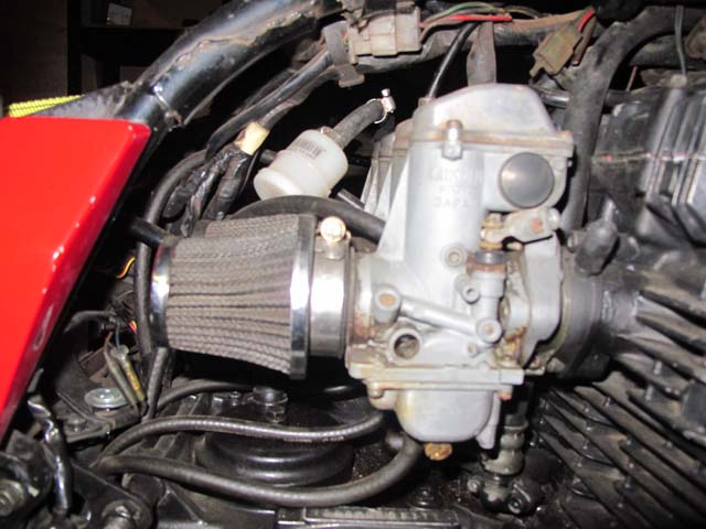

Ok yeah my bad- they are probably not smooth bores... As you said Gos, I think they are 26mm Mikunis of the 1976 Z900A4 model, or even off an early GS750? Admittedly, they need to be cleaned, as they leak when i leave the fuel tap on... there's a huge flat spot just as you take off - I need to blip the throttle before I take off or I stall the bike. This in combination with the bike not idling well has made for extreme concentration and on the odd occasion embarrassment at the lights

and from the other side

OK - I think you may have the GS750 carbs, here is a pic of a set of 26mm Mikunis from a 1976 Z900A4.jacobb wrote:.... I think they are 26mm Mikunis of the 1976 Z900A4 model, or even off an early GS750? Admittedly, they need to be cleaned, as they leak when i leave the fuel tap on... there's a huge flat spot just as you take off - I need to blip the throttle before I take off or I stall the bike. This in combination with the bike not idling well has made for extreme concentration and on the odd occasion embarrassment at the lights......
You can see in this picture - although the carbs look really similiar - there are some slight detail changes in the internal drillings ? There are some additional inner drillings on the carbs you have, which are probably specific to the GS750 jetting (if these are GS carbs - I don't have any good close-ups of much Suzuki stuff unfortunately...) - you can see these clearly right under the choke lever.
The flat-spot is a massive leaning out, due to the use of the pod filters. You can dial this out by richening up the idle mixture and fitting bigger pilot jets.......but its a bit of mucking around to get it right with these filters. Better bet by far, is get some Z1000J carbs from a wreckers, and fit those up
