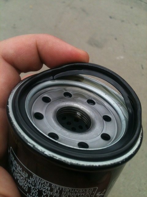

More so the filter from my end. I had done 100 oil changes without but I had an oil filter o-ring blow on me one day maybe due to too tight or loose..... Not quite sure but it covered my rear tyre with oil and sent me down the road so now I just do it correctly.
Don't know about super cheap auto oil. Someone would have more knowledge on it than me.
I just figure you have a 10k bike under you that could throw you down the road for the sake of saving $25 is it worth it.

Ive also recently had a k&n filter blow the o-ring which made the last session a little more exciting than normal :lol: I may have overtightened it though :oops:
Will be using OEM once my supply is used up!
Glad to hear it wasn't just me, it sucks as I don't actually know why it happened. Maybe too tight ,maybe too loose ,maybe a manufacturing fault.
Now I just torque it correctly and stick with OEM which funnily enough are cheaper than aftermarket.
My mate had the same brand aftermarket go on him too!!

The oil filter blowout happened to Dave#3 at PI and left a smoking trail down the straight to about T3 although it was a much earlier model.
Id say it was overtightened in my case. Hand tight plus 1/4 turn now :)
The POS left such a mess :lol:

I think mine was more likely not tight enough or a fault in the o-ring.
Had done four sessions no probs, then fifth session I had no idea it had let go. Went through turn one at broady and apparently there was a bit of smoke. Hard on the brakes dropping down three gears for crash corner. Obviously loading the engine on each down shift and pouring oil over my rear each time. Turned in and before I had even a chance to think I was on my bum.
My rear tyre looked like it had been dumped in a big drum of oil !!!
Then the bike caught fire !!!!!
