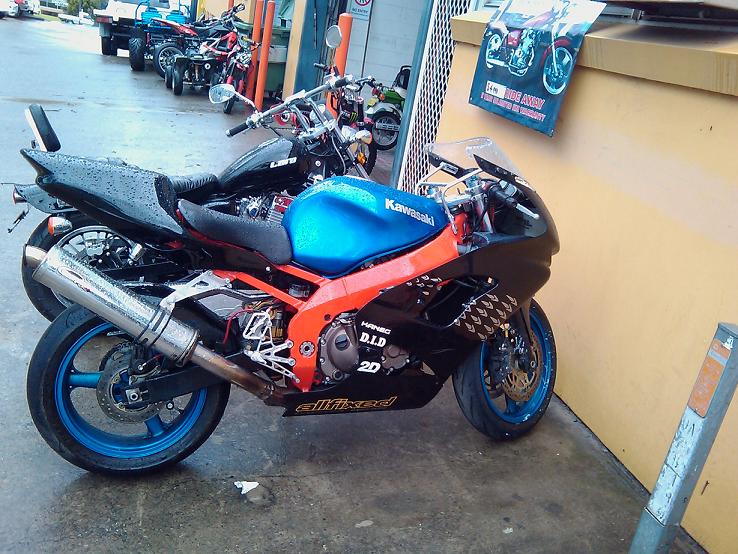

brake pads and my unaustralian tyres to be put on and its all done and ready to go for the 27th.
Might be getting a spare tank and make my dented tank black to fit with the color scheme
- 2011-06-14 15.03.44A.JPG (103.01 KiB) Viewed 6981 times

2nd trackday yesterday.
Great bike, its so fast. The ohlins rear is incredible.
It feels good to have a cbr1000 just draw level at the 150m mark on the straight
I need to either service the front brakes or upgrade.
Any ideas for a good bolt on and more modern brake upgrade?
I had a part fail on me but lucky kev was there and helped me fix it.

Re: 99 zx9r track bike
The standard front road fairing is connected to the headlight which is connectedtim wrote:what actually happened?
to the bracket that supports the dash. This bracket is connected to the frame at the front.
But withl no headlight, no front fairing support. The weight of the fairing was resting on the H frame.
Id been told to put some form of support in to take the weight of the front fairing but
it slipped my mind.
anyway Kev came for a look at eastern creek on friday and just happened to notice the H frame
was cracked at the bottom on the right side. On further investigation both sides were cracked.
It had lasted 1 and a half track days and I did notice that the front fairing was moving round
quite a bit on the straight. Anyway Kev worked his magic and braced it all with zip ties and a
cut up old coat hanger (Macgyver style)
I went back out after missing a session and the bracing was actually stronger than before.
