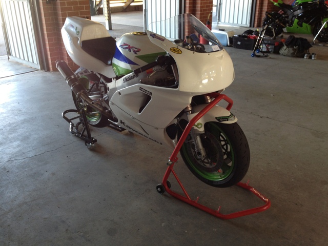

Jim, a pic of the bike you mean? See if I can upload this properly, been having some probs lately doing it....

Ah, remember your bike now, very nice!
