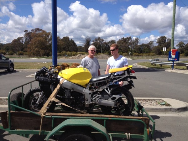

Someone asked for a thread to watch the rebuild, so here it is,
W eve been lucky as it was almost complete, that's all the little bits & pieces, chain, some new after market pieces, some decals even though not quite right, a second engine that seems to be almost new inside, the radiator is the only disappointment as its sat for years & years with water in it & its coroded a bit & having trouble stopping the leaks.
We didnt go after this model or any specific model it was just a random buy on ebay & we now realise we got lucky.

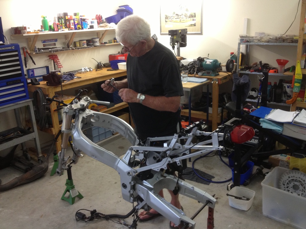

I bought a largish sand blast cabinet & away we went. Full strip down, then an internal engine check then the rebuild.
I'm lucky, dads the other half involved, retired mechanic & loves it, so I supply all the cleaned up parts & he rebuilds them. I'm the ametuer painter but getting there
Anyway the pics should paint the picture.
And thanks to all the blokes here on KSRC for the tips & links & help along the way.
The return from Canberra

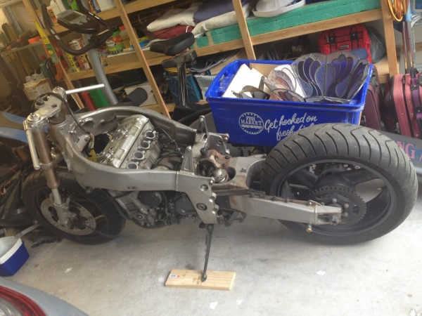

Part stripped

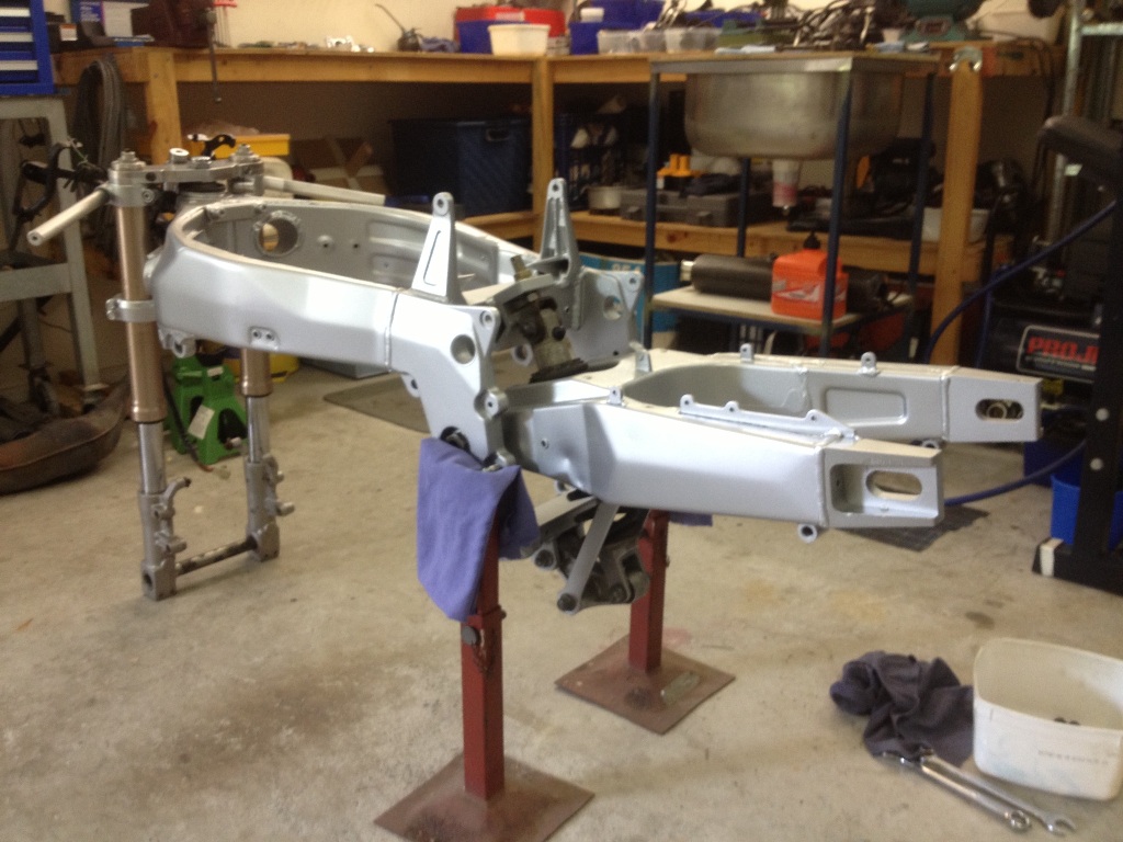

Re painted with Subaru Silver Acrylic Lacquer & cleared over, good colour. Forks rebuilt, new seals etc, swing arm bearings greased up & seals.

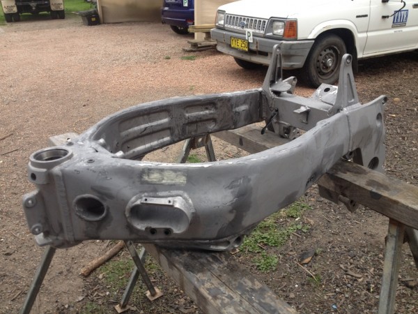

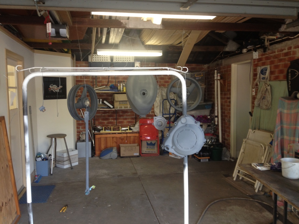

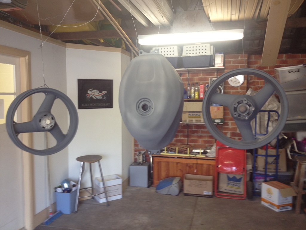

Stripped down in the cabinet & etch primed in the booth / her garage.
zxr 750 94 007.jpg (201.67 KiB) Viewed 9529 times
All the frame, brakes, general brackets & everything into the sand cabinet, stripped & primed ready for paint. Better than new as no factory parts get a primer coat just straight on with the colour & bring on the corrosion.
zxr 750 94 008.jpg (220.76 KiB) Viewed 9529 times

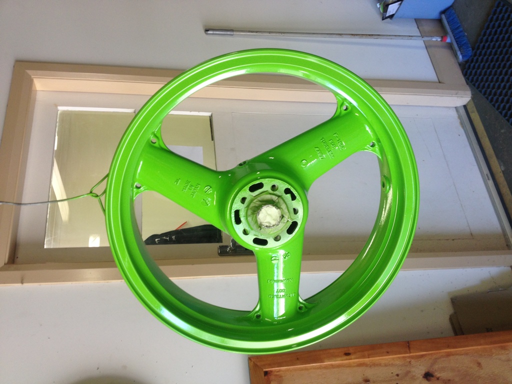

Gone are the black wheels & bring in the green, it was the only Kawasaki green listed in 2 pak & nice colour. They came up like new. Solid green no clear.
zxr 750 94 013.jpg (226.52 KiB) Viewed 9529 times

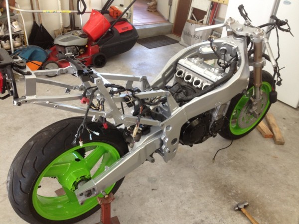

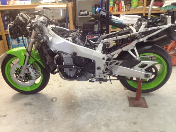

Part 2

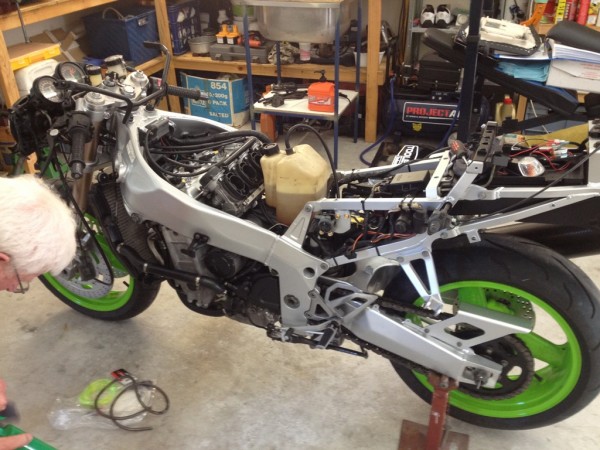

Wheels back on &amp; engine in. Valve cover got a coat of silver &amp; other bits got some black.
Wheels back on & engine in. Valve cover got a coat of silver & other bits got some black.

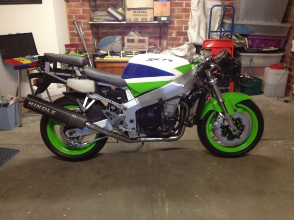

Starting to get closer now, carbies, guards bits &amp; bobs
Starting to get closer now, carbies, guards bits & bobs
Started for the first time in 11 yrs ran like a dream, even dad was suprised.
Getting there, tank isn't quite right, I know, but I'm happy.<br />Thats it for now, this weekend will see more painting &amp; fitting of fairings.
Thats it for now, this weekend will see more painting & fitting of fairings.

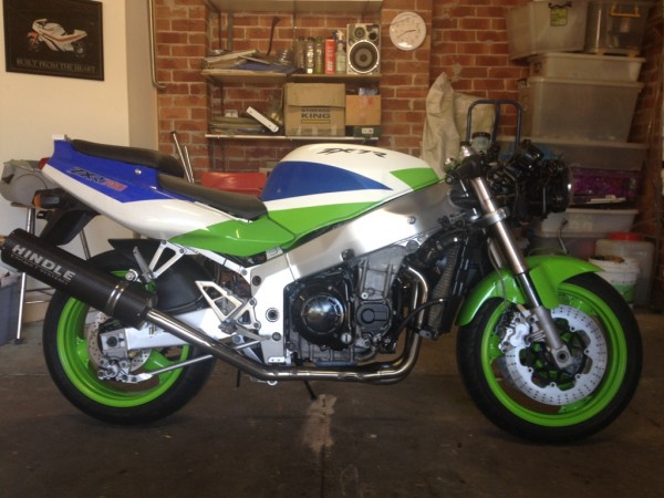

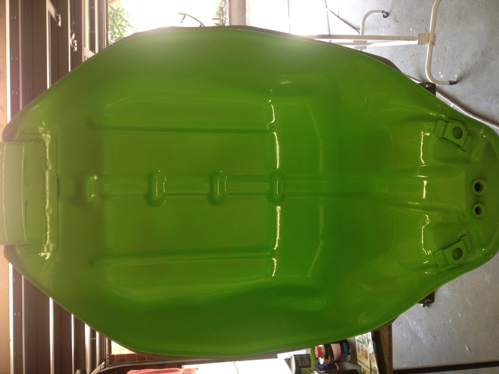

Another day closer thanks to JimZXR, upper rear cowlings.
The green on the tank is the new, off a code down at the paint shop, the only Kawasaki green listed & it's pretty damn close.
