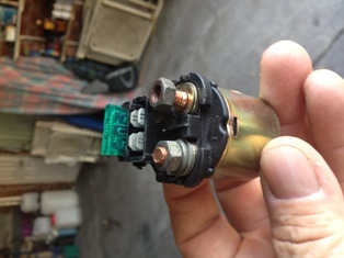

The 2 threaded posts on the regulator, just bridge them carefully & briefly to see if the starter kicks. I'll try and attach a picture.

Got ya, thanks for the pic. will give that a shot and see how she goes
