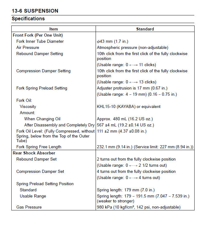

I have the full service manual for 06/07 ZX10r.
Its 14.5mb, and I only have a shitty 3G dongle which most of the time is slower than dial-up...fuggin Optus thieves, but that's another saga.
Its a pdf so I can easily put it in a CD. PM me if you want it.
zx10r fork specs.jpg (132.81 KiB) Viewed 7891 times

The bit that has me scratching my head is how do you check the oil level ? I know is says have the forks compressed and the spring out .. Not sure how the hell you do this whilst keeping the oil in !? :?

wih the springs out - the forks should just compress easily - a wooden dowel makes a good dipstick to check the oil level
Re: Gumby fork seals pls help
If oil is coming out with the forks fully compressed, then there is too much oil in there. I think...
