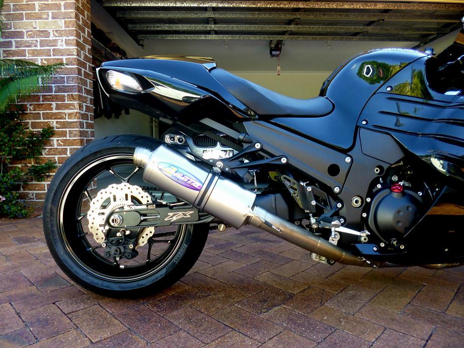

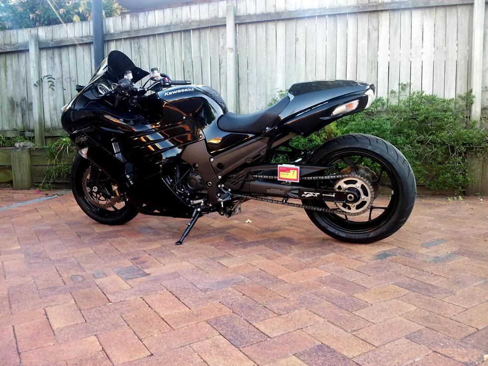

Re: ZX14R Extended Swingarm issue
Here's the pics
- +9LR KSBF.JPG (157.22 KiB) Viewed 12668 times
- +9RExt KSBF.JPG (152.34 KiB) Viewed 12668 times
Looks good how low have you gone in the back and any chance of a pic of the other side?

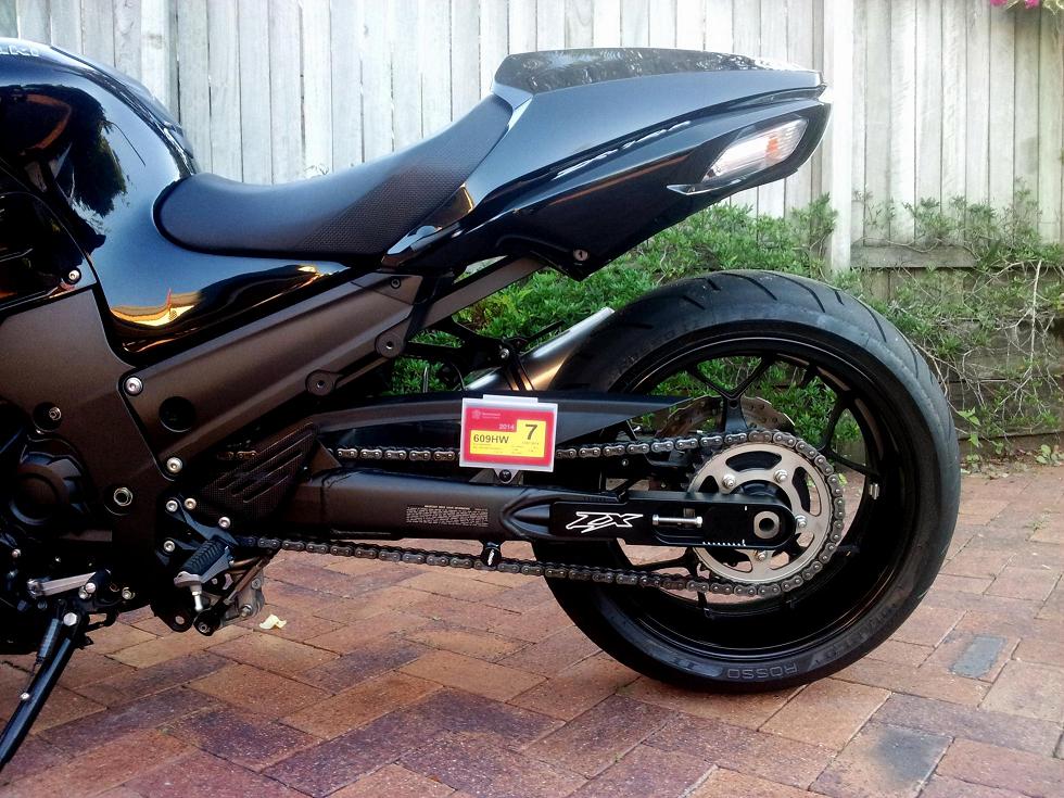

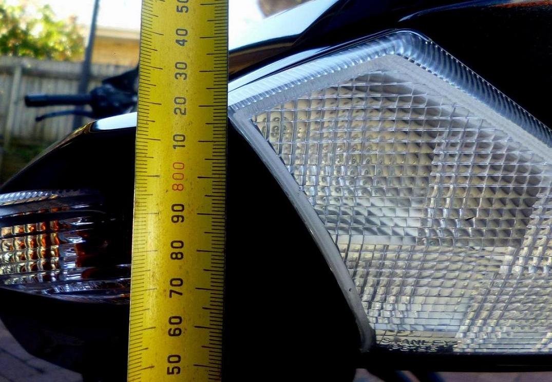

Not sure how much lower it is. Maybe someone with a stock height bike can measure and post the height.MKY wrote:Looks good how low have you gone in the back and any chance of a pic of the other side?
820mm to the point of the light, bike is upright on the stand.
- 9+ RKSBF.jpg (128.68 KiB) Viewed 12665 times
- 9+ RHR.jpg (155.11 KiB) Viewed 12665 times
