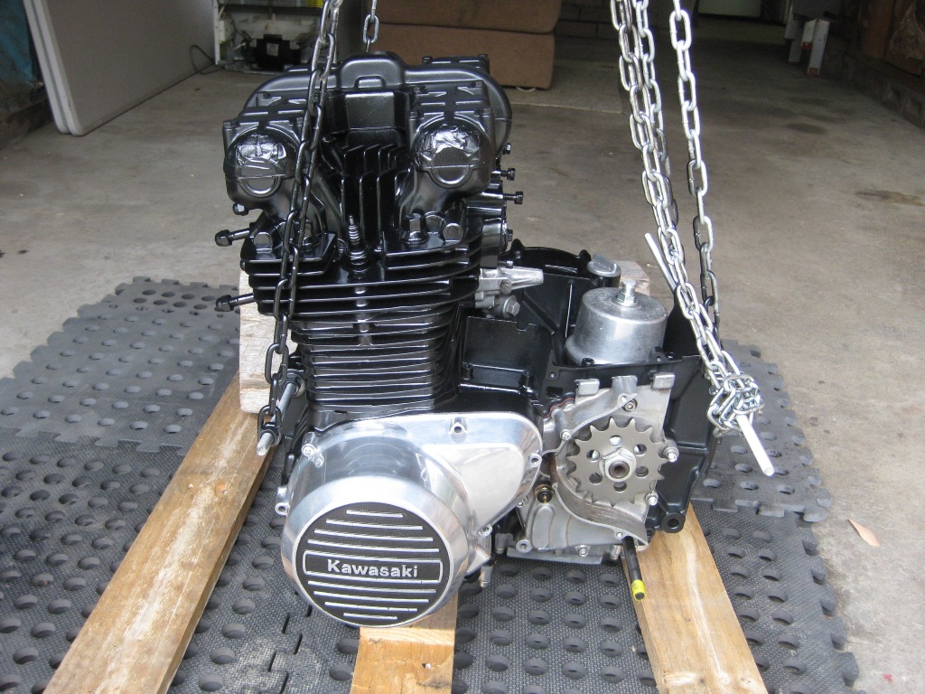

Finally managed to get some paint on my Z1-R engine over the weekend.
Previous attempt was a pretty inconsistent and crappy mess so had to rub/scrub the affected parts back (again!)
Anyway got a chain block and some threaded rod and made up a lifting and supporting rig for the job.
Hoisted up the engine, washed it and blew off any dust/moisture.
Masked off the parts not to be painted and checked temp - about 20degC and not too humid.
Applied the VHT engine enamel (satin black) per the instructions and was very excited to watch the paint dry -
came out pretty good, a huge improvement on the previous fuckup!
Covers to be polished and new RH points cover 2b fitted

Great job, what did you clean the engine down with before hand?
1993 ZXR750 Track Bike
1994 ZXR750 Ongoing project
Re: Z1-R Engine re-repaint
G'day Jim,
Just a very mild soap solution - few drops dishwashing liquid in a bucket of water.
Then wiped down with a clean rag, blew it all dry, masked it up and applied paint straight away before any dust had a chance to settle onto clean surfaces.
Applied several coats - VHT spec calls for 10 mins between coats (with all coats to be applied within 1 hour)
10 mins was about how long it took to go right over/under/around the engine so timing worked out ok.
Very fiddly around the top head fins - needed to attack from all angles to get full coverage.
Used one whole can on the engine, so now have a spare can for touch-ups once the engine is fitted.
(Also have a nicely painted section of chain - hehehehe)
Give it a crack - I'm no paint guru and if I can do it so can you!
Just need to make sure surfaces are clean, free of grease/oil/flaky paint/dust etc
and put lots of thin coats on rather than a few thick ones.
