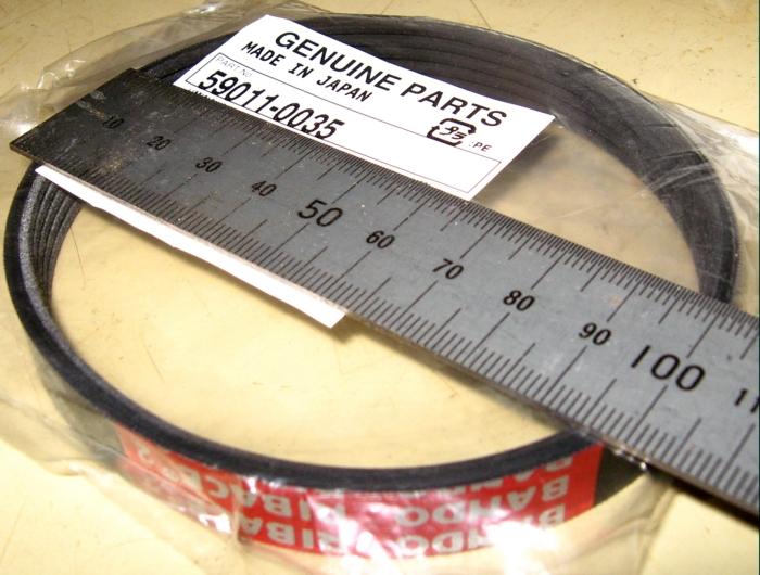

Here is a pic of the wee 5PJ290 Bando Ribace2 with a steel millimetre rule to show the diminutive size:
- gpx750r_alternator_belt_59011-0035.jpg (83.76 KiB) Viewed 25712 times
