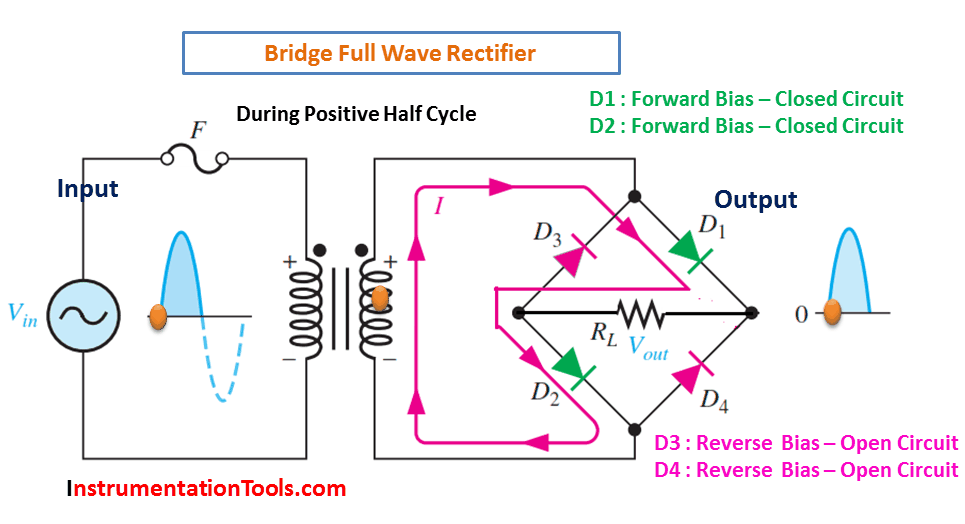

Yes LEDs will only work ONE way. LED stands for Light Emitting Diode. And diodes are devices that allow current to flow in one direction only. Current flows only in the direction of the arrow on the diode.
One diode on an AC supply will convert AC to DC. But the reverse current will be lost due to the diode blocking it. Four diodes are wired together in a diamond pattern to make a Full Wave Rectifier that converts AC to DC. VERY ripply DC but it's DC.

That diagram stuffed up because it's a GIF. Here's one that should come thru OK.
PAH
PAH
- FULL WAVE BRIDGE.png (6.38 KiB) Viewed 23247 times
