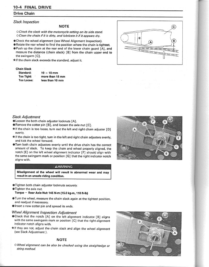

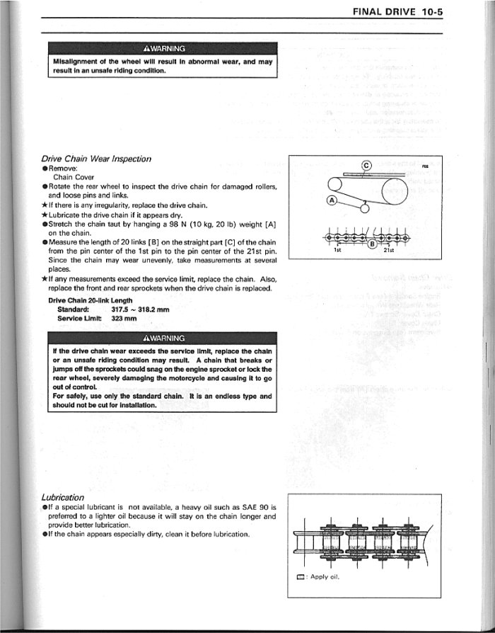

and if you wanna check the chain out
you need the chain specs and chain stretch measurements
as outlined in the manual

some bits from the manual
