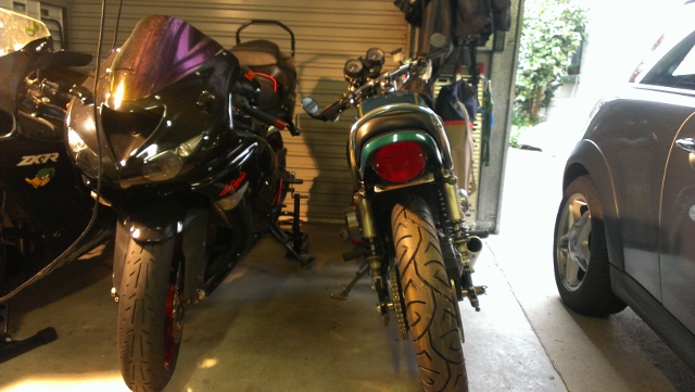

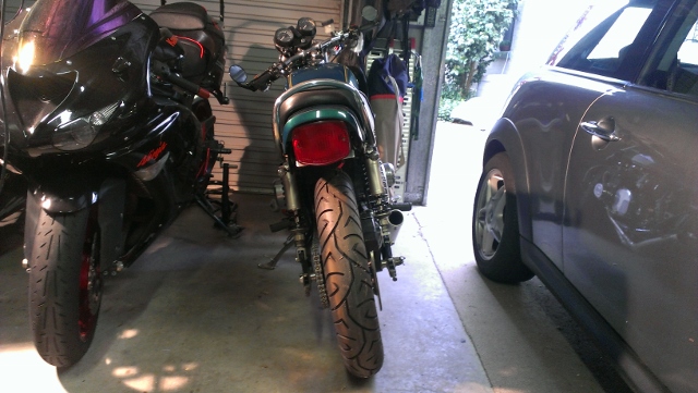

here are a couple from the rear
z1000 tail light.jpg (178.99 KiB) Viewed 12052 times
z900 tail light.jpg (182.47 KiB) Viewed 12052 times
Not sure that it made that much difference from the back, will get it out of the shed when the weather clears to get a better idea. Both were tucked in nicely but the oval shape seems to fit better. I would have liked it to have been a little bigger to fill the space completely.

Thanks mate, no worries just shit stirring you a bit, I was hoping the Z900 light would look so good I would decide 'Yep, thats the one' but now it has made the decision a hard one. Was it easier to fit onto the eliminator than the Z1000 light? Considering I have the Z1000 and it does seem to fill up the space a lot better....... I am thinking about this way too much!!!!!!

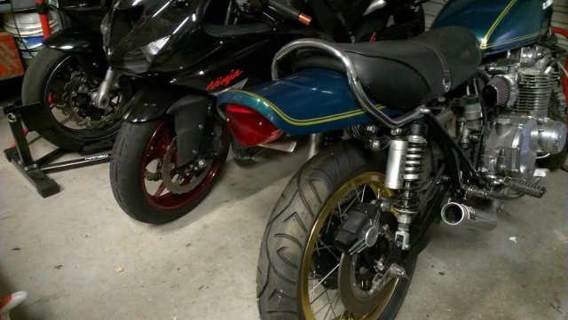

Here is a pic from the side and I think it probably looks a little better, but in my opinion there is not much in it.
z900 tail light 2.jpg (182.2 KiB) Viewed 12051 times
06 zx10r - road
99 zx7r - trackie
77 z1000 - project
z900/zx9
Posts: 2796
Re: 1977 z1000 a1 - modifications
Post by z900/zx9 »
Round looks better ;)

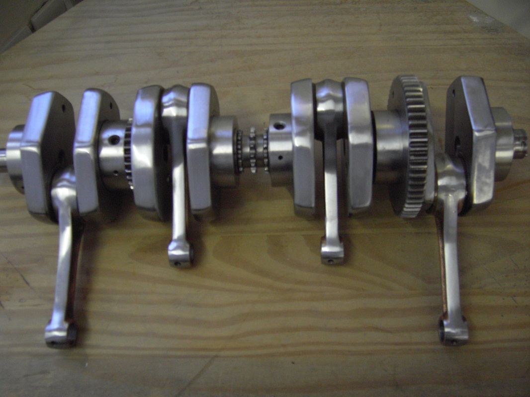

It's been month's since I have had a look at your progress and mate, you've got to be pretty happy with what you've done.The Rickman has taken a lot longer and cost a lot more money than I had expected.The budget downfall started with the crankshaft being on it's last legs, so a $1500 replacement was ordered from Kipkawa in the UK.Balanced and lightened by 2.2kg it should rev quite well and the budget went down hill from there.Just wondering as my son has taken a lot of pic's,would anyone be interested in seeing an old postman rebuild his life time dream bike and the highs and lows that have transpired so far.
